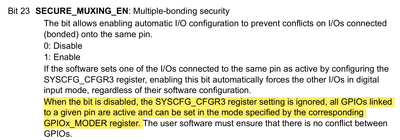

2025-10-11 3:51 PM
In the option bytes, set SECURE_MUXING_EN = 0 and both pins can be active at the same time.
You can set option bytes using STM32CubeProgrammer using the OB tab on the left.
