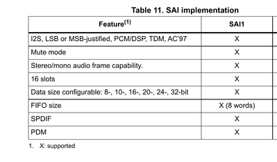

so on cpu without DFSDM  , could try using the SAI : PDM mode
But:
So look on git, sure you can find some pdm->decimation filter , then write your program.
