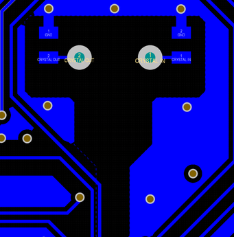

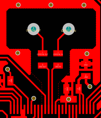

The only problem is that this setup works only when using HSI, but not when using HSE. When I switch to the external crystal (HSE), the clock frequency always stays fixed at 64 MHz, no matter how I change the configuration. The variable 'testcount' also always remains 0.
As both you and TDK suggested, I also suspect that the issue might be due to a hardware design problem with the external clock circuit.
Here are my .ioc file and the crystal design.
Thank you for all the help!

I used HSI to configure the clock to 520 MHz, and I set up TIM1 and assigned its counter value to a variable 'testcount' to track the clock frequency. Everything works perfectly in this case.
As both you and mƎALLEm suggested, I also suspect that the issue might be due to a hardware design problem with the external clock circuit.
Here are my crystal design.
2025-10-11 7:46 AM
Okay, so 20 pF load caps but crystal part number is not stated.

Try smaller caps :
12 pF or so. check.
2025-10-12 1:12 AM
I found out why it didn’t work. Turns out the 0-ohm resistors weren’t soldered properly. Thank you all for the advice!
