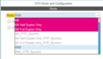

With my board, my ONLY option for the ETH mode is RMII:
If the ADCs are really in conflict with the ETH RMII...does this mean this board is not suitable to run both components simultaneously?

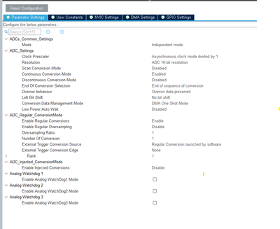

Under the ADC1 Parameter Settings, it should look like:
Save the IOC file and click Yes to generate code.
