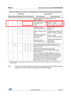

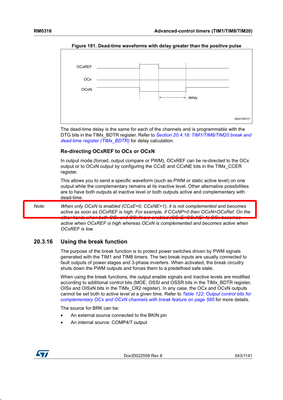

But I told you above, how to do it: the easiest way to do it is to change the pin you want to "force" from AF to output in GPIO (in GPIO_MODER register, and of course setting the required level in GPIO_ODR).
Another option is also to clear the respective enable bit in TIMx_CCER, but the fact that disabling the "straight" output changes the "complementary" output to "straight", may come as a surprise (not that it can't be handled by the polarity bits, but one has to be aware of this fact).
It's just the Forced mode in TIMx_CCMR.CCxM which can't be used for this purpose.

Thanks, I just cleared the TIM enable bit (Thats what I also tryed before) and also set the according polarity bit of the complementary output to 1. This worked :)
Best regards, Benjamin.

Jan, is the behavior that you describe, when disabling the regular channel makes the complementary channel output non-inverted, documented anywhere explicitly?
