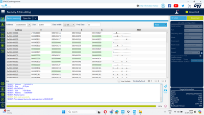

2024-07-16 5:57 AM
Despite following the recommended procedures for writing an application binary to flash memory and subsequently jumping to the application, I am unable to access the flash memory correctly after the flash write operation. It appears that the memory might be overflowing, causing the application not to run as expected.

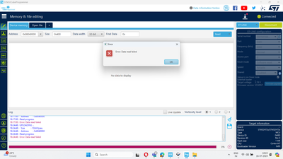

2024-07-16 6:01 AM
I was able to successfully run the application from the bootloader on the STM32F413ZH. The bootloader reads the application binary from a file, writes it to the flash memory, and jumps to the application start address without any issues.
When I used the same bootloader code on the STM32H7 series, specifically the STM32H7xx devices, I encountered a problem. After writing the application binary to the flash memory, I am unable to access the flash memory properly. It appears that the flash write operation completes, but subsequent attempts to read from or execute code from the flash memory fail.
I have tried 5-6 different flashing procedure methods, but none have resulted in a successful operation on the STM32H7xx series. Each method attempted to address potential issues with memory alignment, cache settings, and flash operation flags, but the problem persists.
