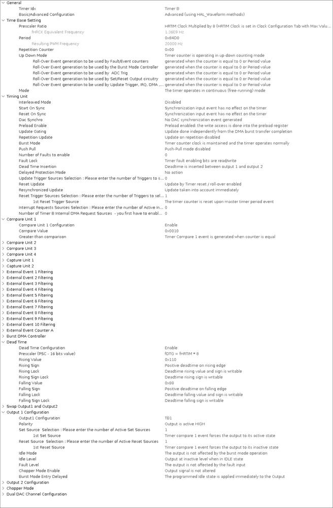

6.16.1:
  • HRTIM1 with slave-timers A,B,E are configured to output 6 PWM-signals with dead time configuration and complementary mode for CH2 of each timer.
  • The output on the logic analyzer is as expected. It shows a duty cycle of 4.6% on CHA1, CHB1 and CHE1(Picture 1 below).

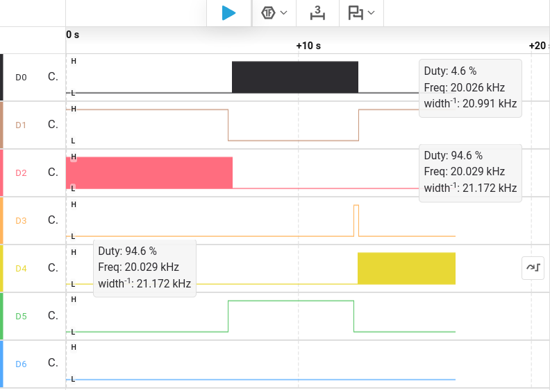

6.17.0:
  • The output on the logic analyzer is not as expected. It shows a duty cycle of 4.6% on CHA1, with CHB1 and CHE1 being inverted(Picture 2 below).
Picture 2Picture 2

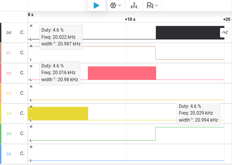

When looking at the difference between the .ioc, hrtim.c and stm32g4xx_hal_hrtim.h in the terminal(Picture 3) there is a few things to remark:
  • There is as expected no difference in the .ioc-files and there is no difference in the hrtim.c/.h files
  • There is a mention of some swapped values, could this be a cause for the problem?
Picture 3Picture 3

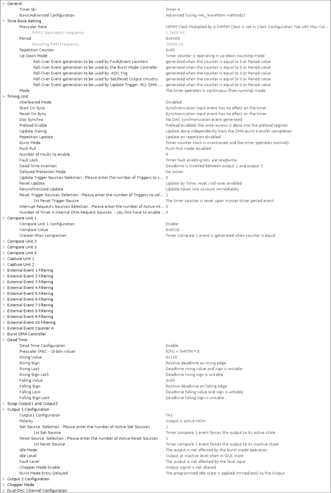

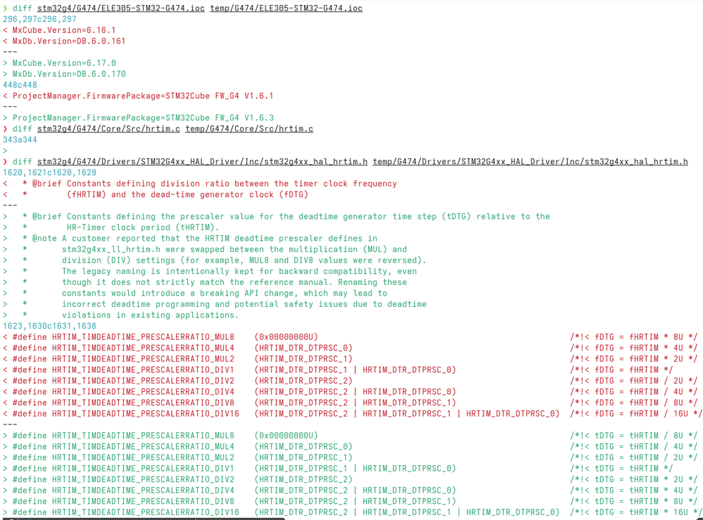

Thank you for your answer. I do not think that the url you have provided is the same problem we are experiencing. We have dead time enabled for Timer A, B and E, with Timer A working as intended with the same configuration for all of them. I have provided pictures of CubeMX with picture 1 showing the config for Timer A that is working as intended and picture 2 showing the config for Timer B which is not working as intended. Timer E is not included here as the configuration is similar to the two others, but it is still experiencing the same unwanted signal inversion as Timer B.
Picture 1(TIM A)Picture 1(TIM A)Picture 2(TIM B)Picture 2(TIM B)
