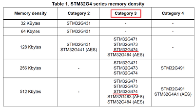

There is an internal pull-up activated during reset and the device you have (STM32G474) and according to the reference manual RM0440 belongs to the category 3:
which doesn't feature the option byte to disable that internal pull up.
So the internal pullup is internally hardwired in your device (category 3). Not possible to deactivate it.
