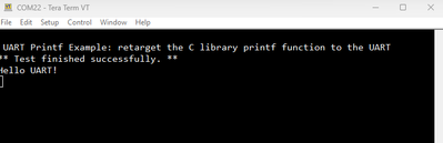

See the main.c file modified in attachment and the terminal result below using PC4 USART1_TX.
The printf and UART Transmit are working now.

2025-05-26 5:42 AM - edited 2025-05-26 5:45 AM
To use strlen(), the string header must be added.
#include <string.h>
To use printf, you must also redirect stdio fputc to USART1.
