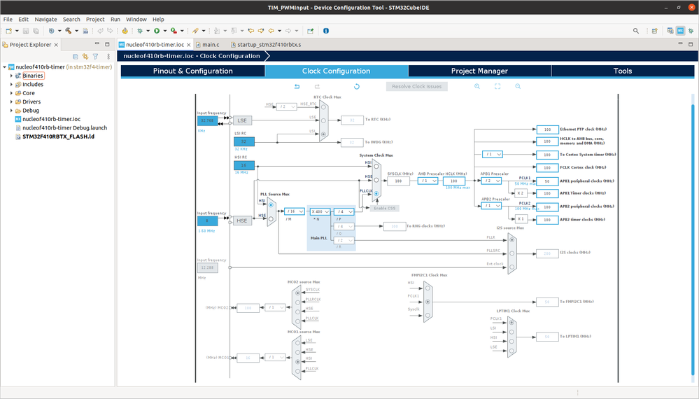

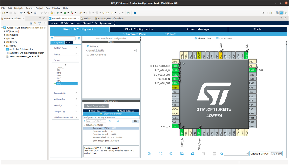

I have been using Tim11 general purpose timer in Nucleo-f410rb micro controller board to blink an led at a delay of 1 second but there is a deviation of 18 ms in it. which have a 16 bit prescaler and 16 bit auto reload counter with it. In the .ioc file the clock configuration section I have set the clock frequency of the APB2 bus timer clock as 100Mhz which is the maximum frequency can be set and the prescaler value as 9999 and Auto reload register value as 9999. Also the datasheet of the board given stm32f410rb datasheet . and the user manual Stm32f410rb user manual
After made the changes in the .ioc file generated code and code is generated for the changes I made and after that i start the timer in the main function like below

I have also provide the ioc file photos

You are using the HSI as clock source, which has an appreciable tolerance on its frequency.
Read this: How to optimize STM32 MCUs internal RC oscillator accuracy

HSI as a primary clock source is not precise, see HSI parameters in datasheet.
