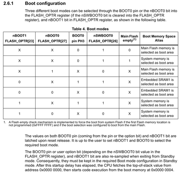

2026-05-05 5:55 PM
according to the AN2606, the MCU STM32L4S is using the pattern6, not pattern1. You can also check the reference manual. for using the bootloader(boot from system memory), you need to set the boot0 pin Low, and nSWboot0 to 1, and make sure the Main flash is empty
