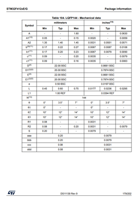

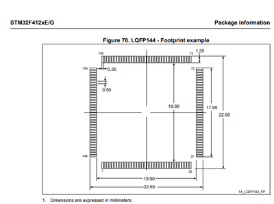

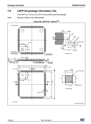

Hello @ivan paul;
Are you looking for LQFP144 package outline and dimensions?
The DS11139 Rev 9 section 7.6 LQFP144 package information (1A) provide LQFP144 mechanical data.
Thank you.
