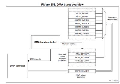

Here the Figure 258. from RM0440 on HRTIM chapter (especially 27.3.23).
On the overview below, there are 3 types of registers :
It is only necessary to have the DMA controller pointing to the HRTIM_BDMADR register as
the destination, in the memory, to the peripheral configuration with the peripheral increment
mode disabled.
Once you write in HRTIM_BDMADR, it's automatically triggers (no need Burst DMA source):
