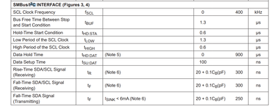

In the MAX6650 document from Analog Devices you shared, it specified that the rise/fall time should be between 20ns and 300ns (cf the figure below)
But on your CubeMx screenshot, you enter 0 ns, please change it and try again.
Let me know !

Before I investigate further, can you please confirm you corrected the rise/fall time. (Timeout fault can be the consequence because the slave cannot follow...)

i have given rise time and fall time as 300ns as mentioned in datasheet.
But i don't know how to calculate rise time and fall time
2023-11-20 6:46 AM - edited 2023-11-20 6:47 AM
Hello @Advance_tech,
300ns is the maximum limit value, please check with 200ns (just in case).
You don't need to calculate rise and fall time. There is, indeed, a calculation with the I2C_TIMINGR but it's unnecessary to do it (tools do). However, if you want to learn more, you can read the chapter 2.2.4 of AN4235 by clicking here.
