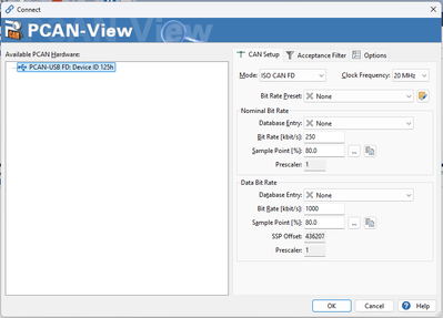

2025-06-13 12:29 PM
Hi!
Has anyone gotten this to work for the STM32H723G with FDCAN bootloader and is willing to share the PCAN-View setup that was used?
Thanks in advance!
2025-06-14 6:35 AM
The Baudrate is 250Kbit/1Mbit. You can use the setup used by Bergen:
Martin
2025-06-16 5:38 AM - edited 2025-06-16 5:38 AM
Thank you, I saw it but didn't interpret it right.
This is the setup that worked for me, on the three dots next to sample point (%) input make sure to choose the tseg1 and tseg2 according to Bergen message linked above.
