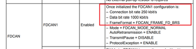

We want to use system CAN bootloader for all of them. Everything seems ok, except STM32H743 device. From AN2606 we know that it starts in bootloader with such FDCAN config: 'Connection bit rate 250 kbit/s', 'Data bit rate 1000 kbit/s', 'FrameFormat = FDCAN_FRAME_FD_BRS'. So, it waits for FD frames.

According to the this part from the table Table 123 / AN2606 "Introduction to system memory boot mode on STM32 MCUs" rev 69:

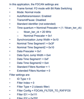

And to the AN5405 "How to use FDCAN bootloader protocol on STM32 MCUs" rev 7:
That's not possible.
You need to have a separate the CAN bus. One for Classic CAN and another for FDCAN format.

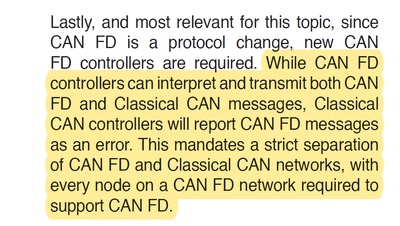

Here you are talking about the FDCAN backward compatibility vs CAN2.0, but what about the CAN2.0 nodes sharing the same bus as FDCAN nodes communicating with FDCAN frames?
Refer to this thread.
And this paper: Hybridization of CAN and CAN FD networks
