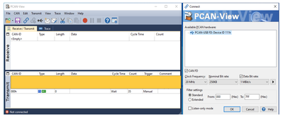

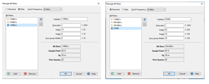

2024-08-26 7:26 AM
I received my custom board with the same MCU, but it has a 208-pin package. However, when I tried to communicate with the bootloader, it didn't respond.
- Used pins are : PH13 / PH14.
- USED Baudrate :
I've tried testing different methods to communicate with the bootloader, but none have worked so far.
Could you please help me with using this bootloader?
I plan to use the STM32Programmer to flash a new application. I've found that to use CANFD, I need to use the STLINK-V3PWR instead of the standard STLINK-V3SET, and I must also add a CAN transceiver to the STLINK. Could you confirm these two details ?

2024-08-27 9:52 AM
The setup seems OK (Baudrates are OK) to get the Bootloader to answer You have to send one of the commands in AN5405.
