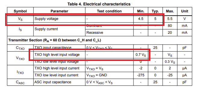

Looking at the transceiver datasheet:
VTXO min = 0.7Vs = 0.7x5 = 3.5V > MCU VDD.
That tranceiver is an automotive grade ans it's not compatible with STM32.
Use a 3.3V transceiver like SN65HVD230 .

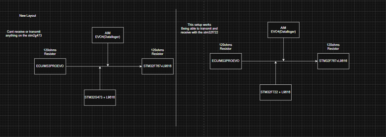

Sure,but wouldnt that be an issue just to send messages? Cause I cant receive any message from the bus,I measured the tx pin with an oscilloscope and it reads a digital signal.
I tested another board that I have with an f722re that doesnt support the fdcan paired with the l9616 and it did connect and could receive and transmit messages to the bus,which to me looked like the issue with the stm32g473 was related with the code or maybe something inside the microcontroller related to the fdcan hardware.

Okay,just resoldered a new microcontroller and then the canBus started working,maybe I damaged these pins when testing or smth.Anyways now everything works receiveing and transmiting with the l9616.
Still probably gonna change the transceiver to have better relliability.
My layout is down here just to clarify what was happening.
Appreciate for the help.
