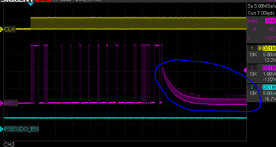

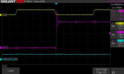

The glitching I'm seeing is more due to my current setup. This is definitely something I will fix, but that requires making a custom PCB. I'm trying to eliminate as many fundamental issues (like that callback not being triggered) as I can before committing to a custom PCB.
Example: 1MHz clock and the MISO line showing a good deal of overshoot along with some other noise sources coupling onto the measurement.

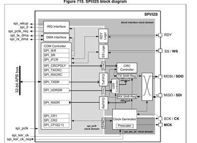

look at the block diagram of this spi :
what will it do, giving constant clk as slave ..? nobody knows.

actually you have to first resolve the MISO signal waveform after the last bit of data :
You should not have this kind of signal.
Having continuous CLK is not an issue if you are able to manage correctly NSS pin to select/unselect your slave device. If your master do not controlled correctly the NSS signal (chip select) then you will face some trouble.
