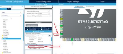

Andrew I really appreciate your support and that of all the members here in this community. Now that the relationship between SCK and bauderate is clear, on my FPGA I can connect one pin to stm32 SCK, one pin to CS and last to MOSI for half duplex comunication (witout MISO line). Now when I go to read the various bits in the code from the FPGA I will do it on the MOSI line, so I will see all the transitions of the bits. This of course I will do at every rising edge of the clock on the SCK line and the bits will be present instead on the MOSI line. So if I connect an oscilloscope on the SCK line output from the stm32 board I expect to see a signal with a frequency equal to the bauderate set in the cube IDE interface as in the attached image right?
