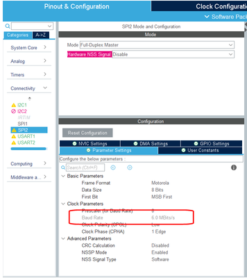

Hello everybody. I asking now for some help on my new project. On my stm32 u575zit-q i want send some bits, as master, on the FPGA EP2C5T144C8N as slave. This FPGA board is very simple (have no other peripherals on it). So i want send by means SPI, four bits in one pin of the FPGA. I know how write code for the SPI in stm32 using MOSI, CS, but now i am focused on SCK (serial clock) that the FPGA need to use for read some bit. I tried to found some on the web but i didnt. Have some one things to help me? On CUBE IDE i see the baude rate (Mbits/s for example set to 1 Mbit/s), but what aboout the SCK that the stm32 board transmit on the SPI pin? I have one idea of how i can implement and i share this with you: on CUBE IDE, if i knew the sck frequency, then i can set some check on my FPGA for read on the rising edge of the sck line, the data sending on the MOSI line of the STM32 board and load this value in some interna register of my FPGA to use it as I need later.

Hi Andrew, it know that SCK is essential but as i know, the sck is a frequency that need to read some value on the varius setting mode (SPI Mode 0 for example), so every rising edge of the sck the slave read the data line of the MOSI. Question: the sck is auto set by selecting SPI setting (this my doubt) or i need to set some timer on some pin as sck? Since i am using stm32 board as master and FPGA board as slave, i think i need to know the sck to say to FPGA when read the data on MOSI line.

Yes, the SCK frequency is a parameter you set; eg, in CubeMX.
ST refer to it as "Baud Rate"
In general, you can pick any value you like up to the maximum which the slowest Slave supports.
As it sounds like you have only 1 slave - your FPGA - you can pick any value you like up to the maximum which the FPGA implementation supports.

Okay Andrew, since my FPGA board is very simple, it have no SPI interface on it. For this reason i wanted know the sck frequency and not the data speed in Mbit/s.
2025-01-27 3:50 AM
I am counfused on the : SCK frequency and on the data speed? Which is the difference beetwae them?
2025-01-27 3:56 AM - edited 2025-01-27 4:52 AM
Data speed reflects the clock frequency.
1Mb/s data -> 1MHz of the clock frequency. Each bit transferred corresponds to a period of the clock: https://en.wikipedia.org/wiki/Serial_Peripheral_Interface#/media/File:SPI_timing_diagram_CS.svg
