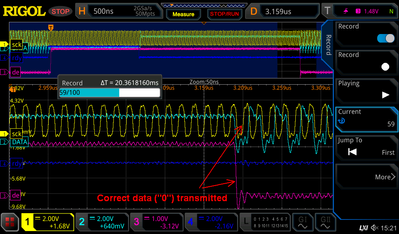

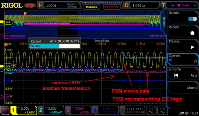

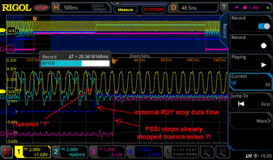

On following scope traces can be seen, that PSSI transmites "1" before RDY blocks data flow. When reciever is ready to accept data, asserts RDY and PSSI transmitt "1" again. Data consis of alternating 0 and 1, therefore PSSI should never transmit two same data consecutive.First transmittion after RDY assert
Lastr transmittion before RDY deassert
overall view
this event happens when program "reload" DMA (tracked by signal on PB8)

But when i add some delay into "DMA reload" routine, problem dissapears. Following scope trace show that situation:with delay, it is ok
but then another error appears somewhere else in the data instead. For now I am not able to locate them exactly to rule out that it is a problem in the receiver. Even so, the problem described above is enough to make the transmission unreliable.
