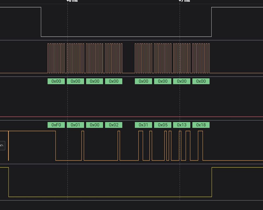

Is the logic analyzer image you posted from a transaction that succeeded or failed? The 2nd trace from the top looks like the clock, and the 4th from top looks like MISO. What are the top and bottom traces? Either one could be the SS. Are you using the hardware NSS feature?

The transaction is success as all the data is seen on the line.
The top one CS from master here it is microprocessor . The bottom one is ATTN line which slave drives low to send data to microprocessor.
