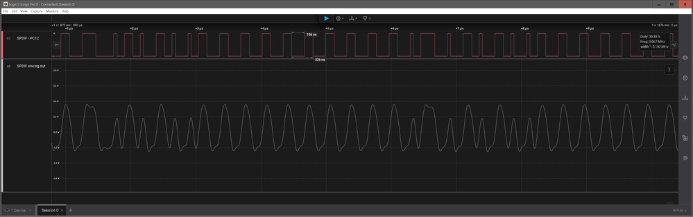

I am struggling since days to get "my audio" out via SPDIF (electrical).
What I see on scope (there is a voltage divider and cap for DC-free on PC12, Vpp is 0.6V, approx. 75 Ohm impedance):
It makes sense - but my SPDIF receiver (a STM32F769I-DISCO board, which works fine as SPDIF receiver with another source) does not get any audio (but it seems to sync and realize there is SPDIF signal, but completely silent).

But when I run this config - it seems to be completely wrong. I check with a scope the SPDIF signal and its frequency. I assume to see this:
So, I tried to trim the SPDIF frequency via scope and I had to configure this:
PLL3P : PLL3M = 1
PLL3N = 18
PLL3P = 96
fractional = 3546
//resulting in 2x 48 KHz for SPDIF signal
So, what I see:
Also not really clear for me:
Even I saw the SPDIF working already (with a lot of distortion) - I cannot replicate neither send a test signal via SPDIF (from a prefilled buffer with sine wave samples).
What is wrong? (I want to see SPDIF working, esp. when I am sure, the SPDIF out via SAI2_B is generated and out there)

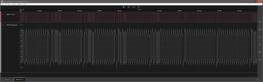

I have used a scope (SALEAE) and SPDIF decoder: yes, I see all words on SPDIF signal are zero on scope!
Why? No idea: the DMA from memory to SAI2 peripheral as SPDIF out is the issue.
I have generated the code via CubeMX, as circular buffer - but it does not work.
When I use Polling mode or INT mode to send the audio to SAI2_B - all works fine. Just the DMA fails.

I "trust" the DMA: during debugging I saw that the DMA src pointer (from memory) is moving and seems to transmit the audio samples to SPDIF DR (data register, also correct address - but no idea what was transferred as value).
I am not sure, if 32bit with DMA works really: I have another (separate issue) where a 32bit word transfer on I2S, from Codec into memory, fails as well (I get just all zeros, even the I2S signal is completely fine).
Based on the changed bit pattern on scope (due to my sine wave in test buffer for SPDIF out) - I assume it should come out on SPDIF as well as a sine audio signal (1 KHz).
Any ideas why my SPDIF receiver does not see any audio samples?
(I have debugged a bit my STM32F769I-DISCO as SPDIF Rx: I do not see any error flags set but the receiver buffer is really all zero - why?) I trust a bit this SPDIF receiver because it works if I play SPDIF from another setup (mainly the same used as Tx) and it works.

The DMA from memory to SAI_SD_B as SPDIF Out FAILS!
It writes all zero (or nothing), even the memory is properly filled with audio samples.
