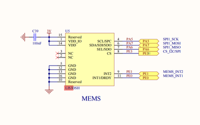

But when I add the pedometer code, which uses SPI1, the value on the screen never gets updated past zero. Is it because I launch a DMA interrupt from the timer interrupt, or do I need to look for problems somehwere else, e.g. in my pedometer logic or SPI1 configuration? The pedometer relies on the accelometer, which is built into STM32F4O7G-DISC1, which is my board, by default

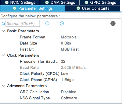

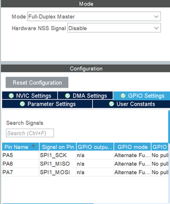

}SPI1 settings
Accelometer schematic
