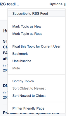

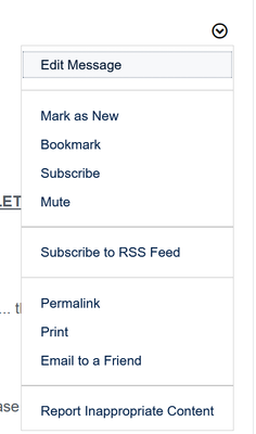

Hi @STOne-32
there does not appear to be an option to delete the post (see screenshots below of the only two menus available at least on my browser)? Surely that cannot be...? How does someone delete a post?
Thank you
2024-08-18 7:27 AM
Right, because deleting content damages the forum. Explain what the issue was and how you solved it, as that might provide some value to visitors in the future.
