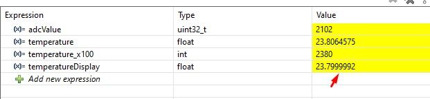

To sum up my project, i get temperature value from NTC. I made ADC reading. There is no problem about getting values. I define temperature value as floating point variable. When observing it on debug screen, because it was floating, numbers after . is too much like seven digit. As you see in picture, is there any way to reduce the number of digits on debug window?
temperatureDisplay

Its a little disturbing. It feels like value changes frequently. I do not need precise measurement. Just two digits is enough for me. This is actually not a problem. I seek for if it was possible.

Instead of the variable itself, you can perhaps display an expression which contains rounded/truncated value.

You can do the calculation in integer. Or in integer fractions ("scaled math", e.g. in 1/10th °C).

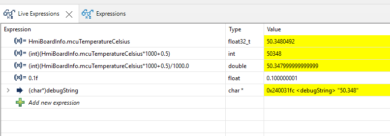

2026-04-02 7:32 AM - edited 2026-04-02 7:40 AM
You may want to scale to an integer. If you want 2 digits multiply by 100, if you want 3 multiply by 1000. etc. Add 0.5 to round.
You can also scale back to float/double, but the downside is that you cannot represent all decimal fractions perfectly with powers of 2. Such as 0.1:
If you want more options you can use snprintf to print the value to a string and then add the string to live expression.
