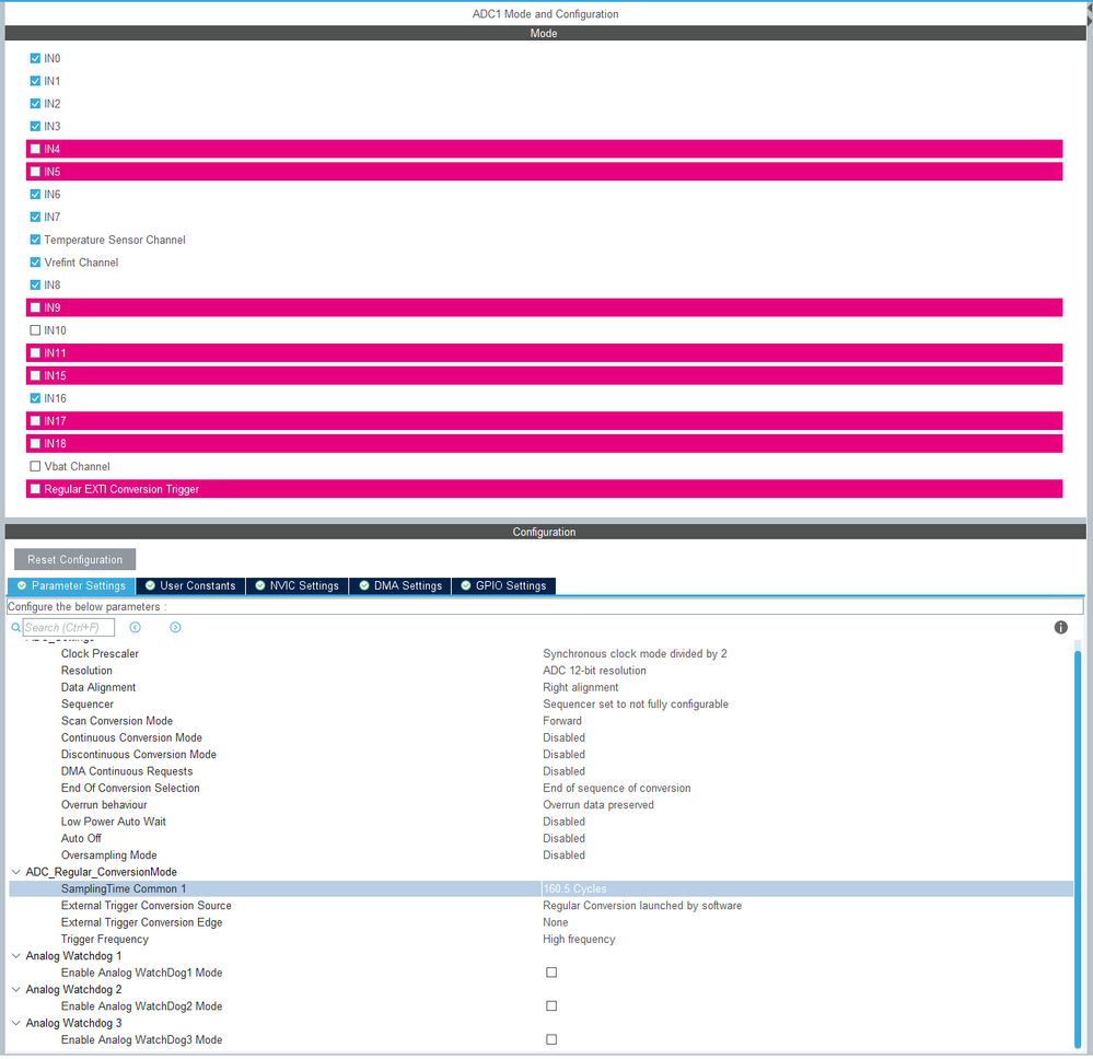

I'm using an STM32G051 and would like to use 12 ADC channels which are not sequential. I have thus set up the ADC for 'sequencer set to not fully configurable' as show below:
Ignore for the moment that IN9 is red, I think I was trying something with one of the comparators to see if that helped.
I'm using the DMA to kick off a new conversion and the callback reports back raw values which I print out as seen below.
If I enable IN0, IN9 or IN10 then I get bad data from the ADC (possibly mixed up channels) as seen below where the VREF+ is being reoprted as over 5V when it should be 3.3V.

2026-04-09 6:00 AM
> The index I use into this buffer follows the order in which the channels are added in the MX_ADC1_Init() function.
This isn't right. The order is the order of the channel numbers.
If you add CH1, VREFINT and CH8, in any order, they will be converted in the order CH1, CH8, VREFINT, since VREFINT is connected to CH13.
So for you, the order is:
(first example): 1, 2, 3, 6, 7, 8, TEMP(VSENSE, 12), VREFINT(13).
(second example): 1, 2, 3, 6, 7, TEMP(VSENSE, 12), VREFINT(13), 16

2026-04-09 8:25 AM
Yes I was starting to work that out earlier when I matched up the numbers with the indices, so thanks for confirming.
It's a shame the HAL stuff doesn't add the channels in the channel order because it's not obvious what the channel numbers are for ADC_CHANNEL_TEMPSENSOR and ADC_CHANNEL_VREFINT, even if you hover the mouse over those macros, unless you know where to look, it's not obvious which part is the channel number.
It also doesn't help that you can't rely on the ordering of the channels in CubeMZ which lists the temperature sensor channel after IN7 and the Vrefint Channel after the temperature sensor (i.e. before IN8).
