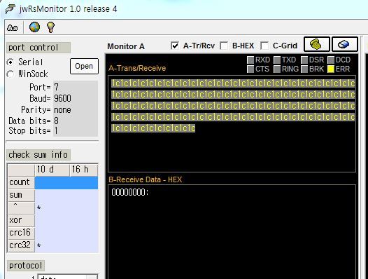

Now I'm trying to implement UART function as the below,
But the problem is keep showing in RS232 Tool.
I'm just referring fully reference posting such as
https://community.st.com/thread/19577?commentID=48791#comment
There's no miss match. But I don't know what is the problem and how to resolve this.
Could you please any advice to resolve this problem?
I guess one thing is there's noUSARTx->BRR declaration.
Is this possible way to happen the problem??

In case TEST 1 and TEST2 have the same output result as the below image.
What am I supposed to do to resolve this problem?
should I have to calculate about
USARTx->BRR

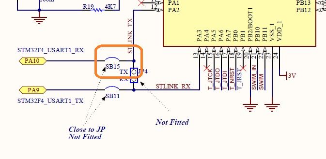

See here, where you were told about removing SB15
https://community.st.com/0D50X00009XkXNtSAN

You would need to make sure HSE_VALUE is correctly defined for the board, perhaps in stm32f4xx_conf.h and be 8000000 and not 25000000. Check also that system_stm32f4xx.c configures the PLL with the expectation of an 8 MHz crystal and not a 25 MHz one.
Unless you change the bus speeds dynamically you shouldn't need to revisit USART->BRR
Send an 0x55 data pattern and confirm the bit timing with a scope. Don't send data to the register unless TXE is asserted, you'll just garble things.

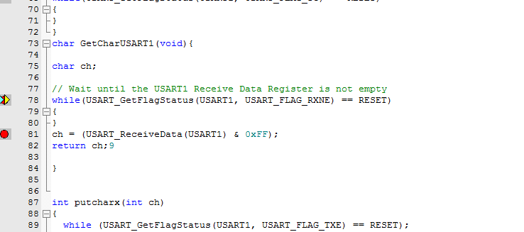

Clive, I'm struggling to receive data from PC with code below.
Sending data from STM32 board to PC is working good.
But receiving from PC has a problem.

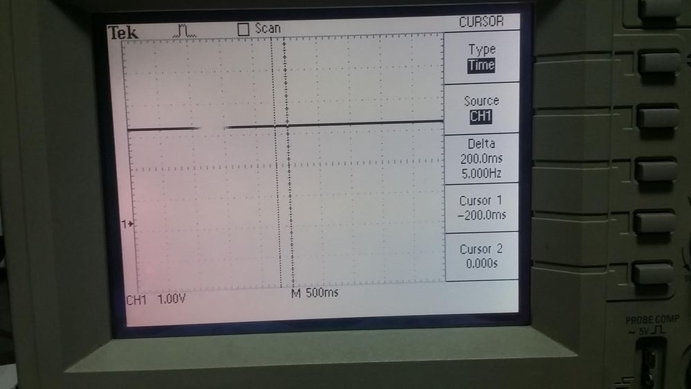

The below image , I just prove the PA10 while sending data.
I'm not sure but would you please check this configuration?
void SendCharUSART1(char ch){
// Wait until TXE is setwhile(USART_GetFlagStatus(USART1, USART_FLAG_TXE) == RESET){}USART_SendData(USART1, ch);// Wait until the end of transmitwhile(USART_GetFlagStatus(USART1, USART_FLAG_TC) == RESET){}}char GetCharUSART1(void){ char ch; // Wait until the USART1 Receive Data Register is not emptywhile(USART_GetFlagStatus(USART1, USART_FLAG_RXNE) == RESET){}ch = (USART_ReceiveData(USART1) & 0xFF);return ch; } GPIO_InitStructure.GPIO_Pin = GPIO_Pin_9 | GPIO_Pin_10; GPIO_InitStructure.GPIO_Mode = GPIO_Mode_AF; GPIO_InitStructure.GPIO_OType = GPIO_OType_PP; GPIO_InitStructure.GPIO_PuPd = GPIO_PuPd_NOPULL; GPIO_InitStructure.GPIO_Speed = GPIO_Speed_50MHz; GPIO_Init(GPIOA, &GPIO_InitStructure); GPIO_PinAFConfig(GPIOA, GPIO_PinSource9, GPIO_AF_USART1); // USART1_TX GPIO_PinAFConfig(GPIOA, GPIO_PinSource10, GPIO_AF_USART1); // USART1_RX USART_InitStructure.USART_BaudRate = 9600; USART_InitStructure.USART_WordLength = USART_WordLength_8b; USART_InitStructure.USART_StopBits = USART_StopBits_1; USART_InitStructure.USART_Parity = USART_Parity_No; USART_InitStructure.USART_HardwareFlowControl = USART_HardwareFlowControl_None; USART_InitStructure.USART_Mode = USART_Mode_Rx | USART_Mode_Tx; USART_Init(USART1, &USART_InitStructure); USART_Cmd(USART1, ENABLE);/////////////////////////////////////////////////////////////////////////////////
SYSCFG_EXTILineConfig(0x0,0);
SendCharUSART1(0x0D);
SendCharUSART1(0x0A);SendCharUSART1('U');SendCharUSART1('S');SendCharUSART1('A');SendCharUSART1('R');SendCharUSART1('T');SendCharUSART1('1');SendCharUSART1('>');// Get and echo USART1ch = GetCharUSART1();while (ch != 0x0D) {SendCharUSART1(ch);ch = GetCharUSART1();}What am I missing?
Currently, stuck in here while(USART_GetFlagStatus(USART1, USART_FLAG_RXNE) == RESET)
during sending the data from PC to eval board.

So you show me a static signal on the USART1_RX and ask why it receives nothing?
Is this pin clashing with the VCP? Did you disconnect the ST-LINK's USART from the STM32F429? Make sure SB15 is *REMOVED*
2017-09-12 9:34 AM

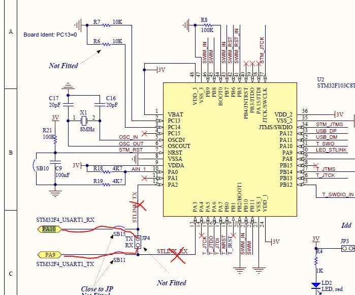

I prove the each pins PA10 and PA9 to PA2 and PA3.
Then I found PA10 is connected with JP4's TX and PA9 is connected with JP4's RX not PA2 and PA3.
I can't find their connection between PA10 and PA2 also PA9 and PA3.

A scope trace with a flat-line is not going to result in data reception, if you are sending data why can you not see it?

Isn't USART1 connected to the VCP on the DISC1 board? via PA9 and PA10.
As you said, I think I have to look for another free pins for using UART.
BTW If I remove SB15, is there any serious problem?
I think it's connecting with 'uart bootloader'.

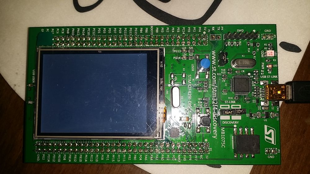

2017-09-12 10:14 AM
No, I'm not using uart pin for uploading firmware. I just connect to mini USB cable.
As you can see the scope trace, I think something work as a barrier to prevent received data from external serial dongle
2017-09-12 10:42 AM
