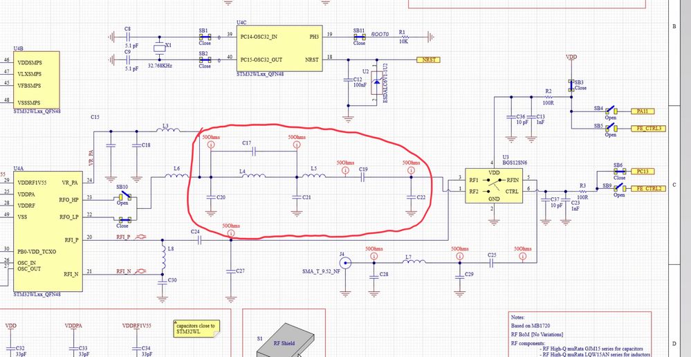

We are developing an ultralight, ultra low power IoT device and the STM32WL seems like a great fit.
We have chosen the STM32WLE5CCU variant (M4 MCU, 256kB, UFQFPN-48) because we don’t need the extra processor core. When designing the board, I ran into a couple issues.
Thanks.
2022-04-07 2:59 AM
It's correct, you need first an LC cells to match the output to 50Ohms and next you could insert a bandpass filter. I can provide you the impedance you have to present to the chip but I have to know at which frequency do you operate and what is the desire output power ?
