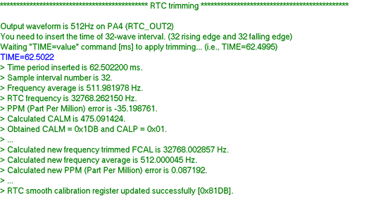

}The following output is generated via the UART interface:
Afterward, I monitor the signal on the RTC_OUT2 pin, but the waveform remains unchanged, even after a long wait.
So, how can I verify if the RTC has been trimmed correctly?
Is there anything wrong with my procedure?
Thanks and best regards,
Moreno

Your instruments are going to detect a change from 511.982 Hz to 512.000 Hz? What are you using to measure? What frequency is the measurement?
