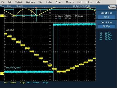

2024-06-19 9:37 AM - edited 2024-06-19 9:43 AM
and it works!
TIM1 is used as master with PWM output and TIM2 is used as slave to trigger the DAC. I had some issues at the beginning because I realize later on that TIM1 is attached to APB2 with double the clock with respect to TIM2 which is attached to APB1! I've then set APB2 with the same clock and TIM2_PSC = TIM1_PSC/#_LUT_points: by doing this I-m using the same value for ARR on both the timers and I'm good to go.
The frequency is adjustable from 10 to 500Hz and duty cycle from 20 to 95 %
Here attached an example at 200Hz with 60% DC.
Many thanks Jan for your great help!

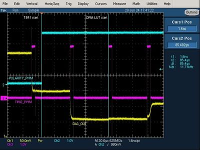

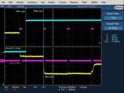

2024-06-21 2:30 AM - edited 2024-06-21 2:36 AM
Hello again,
I noticed that, despite the 2 timers are synchronized, there is a delay of TIM2 (slave) with respect to TIM1 (master). Please have a look at the attached picture to better understand the issue.
I think we have 2 problems here:
- TIM2 is not perfectly synchronized with TIM1 - the minimum delay that I measure is around 36usec. This is acceptable for my application but I was expecting a better sync considering that the core is running at 180Mhz...
- The first point of the DMA LUT is delayed by about 85usec, and this is still acceptable but we are at the limit. Maybe here I'm messing up with something in the code and I'm asking your help in understand what this could be
I've tried to play with the master/slave mode option on both the timers (the one that is referring to delay the TRGO/TRGI) but nothing is changing in the waveforms. Also, it is not clear to me if this option needs to be enabled on the Master or on the Slave timer....
Overall I'm ok with the solution I've implemented but I want to understand if I do something wrong and how I can improve.
Thanks,
Max
the following picture is showing the delay between the polarity PWM period start (TIM1 - master) vs the DAC LUT period start (triggered by TIM2). TIM2_PWM has been activated only for measuring purposes.
this is showing the minimum delay between TIM1_PWM (master) and TIM2_PWM(slave)

I don't know how exactly do you perform the synchronization and DMA start. Details do matter.
Generally, if you use Trigger mode of the slave-mode controller to perform synchronization, the slave timer must not be enabled by software (i.e. TIM2_CR1.CEN must remain 0 until the master is run).
2024-06-22 2:35 AM
Here the init of the involved Timers + the 3 instructions used to start everything. The PWM start for TIM2 is used only for debug purposes so I can see PMW signal and measure the difference.
It is maybe that I have to start the DAC DMA after the master timer ?
