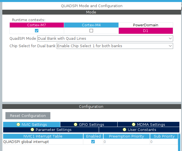

I just would like to write/read to/from external flash on the development board and will really appreciate a hint how to make the easiest way.
I have configured QUADSPI interface only for M7:
QUADSPI Mode: Dual bank with qaurd lines
Chip Select for Dual Bank: Enable Chip Select 1 for both banks.
And use example application for STM32H7h7-EVAL board.
Right now the flash erasing command fails:

2020-04-28 7:03 AM
Oh. Thank you for the swift reply.
Falls like this:
There is a check for status In the HAL_QSPI_Command_IT
if(hqspi->State == HAL_QSPI_STATE_READY)The dubugger shows that the vlue is "BUSY_AUTPOLLING". Without interrupts means just removing.
HAL_NVIC_SetPriority(QUADSPI_IRQn, 0, 0);
HAL_NVIC_EnableIRQ(QUADSPI_IRQn);?
I am also curious wether default configuration generated by the is correct, when it writes flash szie is 1.
QSPIHandle.Instance = QUADSPI;
QSPIHandle.Init.ClockPrescaler = 255;
QSPIHandle.Init.FifoThreshold = 1;
QSPIHandle.Init.SampleShifting = QSPI_SAMPLE_SHIFTING_NONE;
QSPIHandle.Init.FlashSize = 1;
QSPIHandle.Init.ChipSelectHighTime = QSPI_CS_HIGH_TIME_1_CYCLE;
QSPIHandle.Init.ClockMode = QSPI_CLOCK_MODE_0;
QSPIHandle.Init.DualFlash = QSPI_DUALFLASH_ENABLE;Sorry :) I am totally newbie in the STM world.
