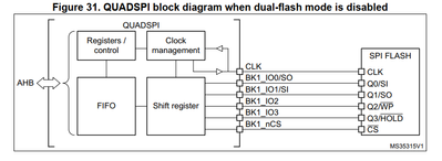

I'm designing a system to use a quad spi memory for log purposes. And I see that the L412R8I only features qspi bank 1 on AF10
Bank 0 is missing
Is it okay? I'd only use it by indirect access, because the memory is to be read and written

2024-09-25 4:11 AM
Hi Tesla
I will check that asap.
Now regarding the qspi electrical connection, is okay to work with the bank 1 instead of zero? Unless that i'm missing something, there is no bank 0 in the L412

2024-09-25 4:58 AM
Sorry!
My bad...
