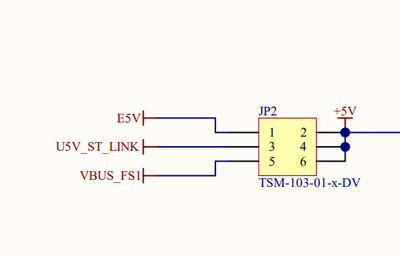

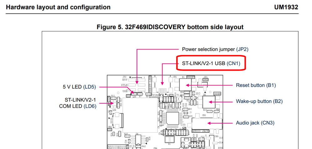

Why are you using CN13 to connect to the board? CN13 is used for USB of the chip.
If you need to power the board with USB, you need to close JP2 on 3-4 position.
And you need to connect to CN1 over ST-LINK to connect to the board.

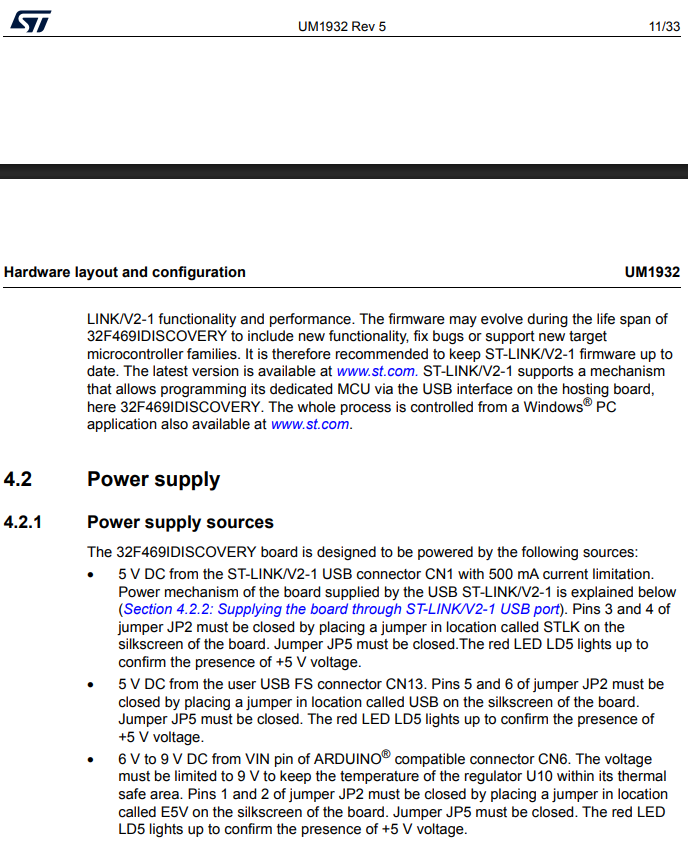

@alw wrote:looks to be powered ok via USB connector CN13
Full details of the powering options are in the User Manual:

For programming and/or debugging, use the built-in ST-Link on CN1:
