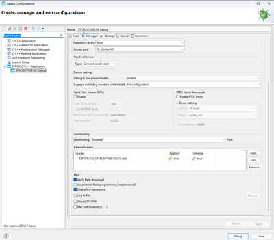

Problem Description:
I created a new TouchGFX project for the STM32H750B-DK board. The project builds successfully (0 errors, 1 warning), but I cannot debug it. When starting a debug session, I get the error: "Cannot access memory at address 0x90000000".

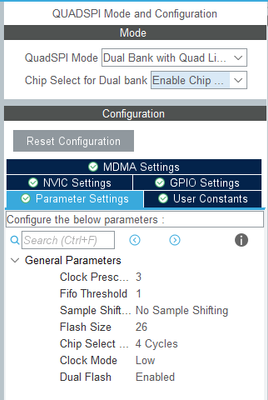

The project is configured to use external QSPI flash (0x90000000) for code execution (XIP) since the code size (424KB) exceeds the H750's internal flash (128KB).
What Works:
  • Project builds successfully
  • Simple non-TouchGFX blinky projects debug successfully
What Fails:
  • Debug session fails with memory access errors at 0x90000000
  • Attempts to set SP/PC from external flash vector table fail

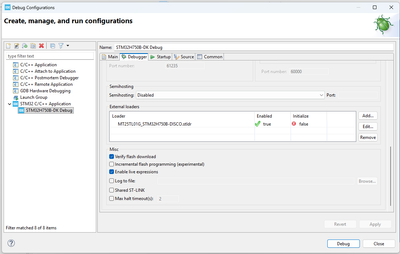

Any guidance on proper debug configuration for external flash execution would be greatly appreciated!
NOTE: Shouldn'e external loader be found, where?
1 ACCEPTED SOLUTION
Accepted Solutions
Successfully Recovered a Locked STM32H750B-DK (DK32H750B$AT1) - Step-by-Step Guide: After an intense debugging session that left my STM32H750B-DK board in a hard lockup (ARM core in lockup state), I managed to fully recover it. Since this process involved several non-obvious steps, I'm documenting my journey here to help others who might face a similar "bricked" board. My Board: STM32H750B-DK, Product ID DK32H750B$AT1 (MB1381-H750XB-B01). Summary of the Problem The board became completely unresponsive after a failed attempt to run code from external QSPI flash. The debugger reported a "lockup" state, and the chip would not execute any code or connect properly. The Step-by-Step Recovery Process 1. Initial Assessment and Tool Setup Tool Used: STM32CubeProgrammer (Version 2.21.0). Key Insight: Normal connection methods failed. The critical feature to use was "Connect Under Reset" to halt the core before any faulty code could run. 2. Critical Connection Method In STM32CubeProgrammer's ST-LINK configuration: Set "Reset Mode" to Hardware reset. The sequence is timing-sensitive: Physically press and hold the black NRST button on the board. In the software, click "Connect". Only release the NRST button after the connection is established and the "Target information" panel populates. 3. Performing a Clean Full Erase Once connected, I did not program a new file immediately. Went to the "Erasing & Programming" tab. Under "Automatic Mode", clicked the text link for Full chip erase. This erased both internal and potentially corrupted external flash, giving a clean slate. 4. Programming a Known-Good Test Firmware I created a simple LED blink project configured for internal flash (0x08000000) in STM32CubeIDE. Back in CubeProgrammer, I programmed this .elf file using the same "Connect Under Reset" method. Verification passed successfully. 5. Board-Specific Quirks and Verification LED Confusion: On my board revision, the user LED is the bicolor LD2. The pin PG3 controls its red segment. Don't be alarmed if LD4 (green) stays on—it's a power indicator. Power Port Matters: For the final autonomous boot test, powering the board via the dedicated CN15 (PWR) USB port provided a clean power-on reset. Using only the CN1 (STLK) port for this test could be unreliable. Success Test: After programming, a full power cycle (unplug USB, wait 10 seconds, replug into CN15) made the LED blink automatically, confirming a full recovery. Conclusion The key was using ST32CubeProgrammer's "Hardware reset" mode to gain access, followed by a full chip erase to remove any corrupted code. The board's power delivery via the correct USB port was also essential for testing standalone boot. I hope this log helps someone else recover their board. I will address the separate challenges of configuring the QSPI external flash for TouchGFX in a future post.

  /* QUADSPI parameter configuration*/
  hqspi.Instance = QUADSPI;
  hqspi.Init.ClockPrescaler = 3;
  hqspi.Init.FifoThreshold = 1;
  hqspi.Init.SampleShifting = QSPI_SAMPLE_SHIFTING_NONE;
  hqspi.Init.FlashSize = 26;
  hqspi.Init.ChipSelectHighTime = QSPI_CS_HIGH_TIME_4_CYCLE;
  hqspi.Init.ClockMode = QSPI_CLOCK_MODE_0;
  hqspi.Init.DualFlash = QSPI_DUALFLASH_ENABLE;
  if (HAL_QSPI_Init(&hqspi) != HAL_OK)
    Error_Handler();

are getting any TouchGFX  GUI content on  display without debug?
are you selected correct Externer Loader in the CubeIDE?
Dose QuadSPI BSP initialized correctly?
TouchGFX GUI is simple Analog clock only, just for trying the MVP esign pattern.
STM32H750B-DK Lockup After External Flash Programming - Seeking Recovery Advice:    I've been trying to run code from the external QSPI flash (MT25TL01G) and have gone through an extensive debugging process that ended with a hard lockup. Below is a detailed log of my steps.

A. CubeMX & Project Configuration
  • Created project via Board Selector (not MCU selector).
  • Verified QUADSPI configured in Memory-Mapped mode (Clock Prescaler=2, CS High Time=2, Flash Size=26).
  • Linker Script: Manually confirmed .ld file defines FLASH region at ORIGIN = 0x90000000.
  • Issue: The CubeMX "Application runs from" / "Application Entry Point" setting was greyed out/unavailable in the Project Manager, preventing automatic VTOR configuration.
B. Programming & External Loader
  • STM32CubeProgrammer: Successfully programmed my .hex file to 0x90000000 (log confirms full erase, download, and verify).
  • External LoaderMT25TL01G_STM32H750B-DISCO.stldr is selected with both Enabled and Initialize checked in the IDE debug configuration.

ksale.1
Senior II
(MT25TL01G) and have gone through an extensive debugging process that ended with a hard lockup. Please find the full posting the following linkhttps://community.st.com/t5/stm32-mcus-touchgfx-and-gui/stm32h750b-dk-touchgfx-project-quot-cannot-access-memory-at/td-p/877543
