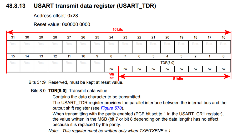

See also the device Reference Manual - see how the parity and extra data payload bits are handled...

@ManhPham wrote:
Which transmit command is correct?

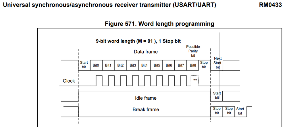

As the documentation says, It depends on how you UART is configured - 8-bit (or smaller) data, or 9-bit data.
For 9-bit data, you need two buffer bytes for each transmitted UART Frame:
        |<-------------------------------------u16------------------------------------->|
Buffer: | -- : -- : -- : -- : -- : -- : -- : b8 | b7 : b6 : b5 : b4 : b3 : b2 : b1 : b0 |
PS - disclaimer: I don't know if that's the right bit/byte ordering - but you see how it takes two buffer bytes to contain the 9-bit payload?
