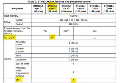

Hi, in this STM32L4Q5RGT6 microcontroller of (LQFP48) package how many SPI, QSPI should be connected.

Hello @abhishek_25 and welcome to the community;
According STM32L4Q5 datasheet; STM32L4Q5RGT6 supports 3 SPIs and maximum 2 OCTOSPIs (available only on multiplexed mode).
Thank you.

Hi Kaouthar
so can I use two spi and 1 qspi in LQFP48 package.
2026-01-21 11:40 PM
Yes, you can.
Thank you.
Kaouthar
