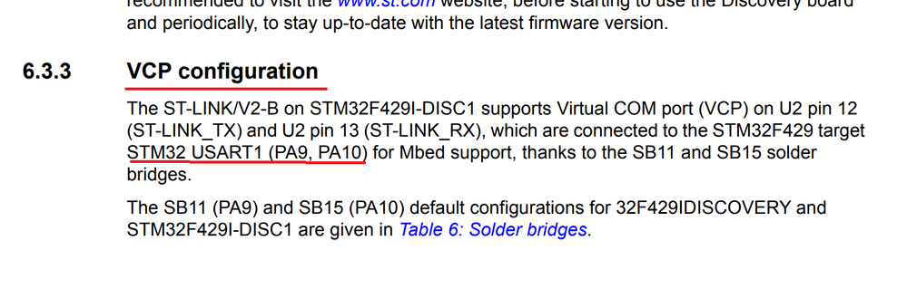

@mƎALLEm wrote:From the user manual of the board

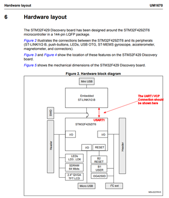

@mƎALLEm This is another case where the Hardware block diagram (Fig 2) in the UM could be more helpful:
2024-11-12 3:39 AM
Already mentioned in the User manual of the board:
2024-11-12 4:02 AM
Is this a new board?
Because older revisions (B01) of it did not have the VCP capability.
Revision should be displayed on a sticker on the bottom of the board.
2024-11-12 4:11 AM
Yes, but it would be more helpful if it were also shown in the block diagram.
2024-11-20 1:32 AM
@waclawek.jan wrote:older revisions (B01) of it did not have the VCP capability.
I guess that's why it's not shown on the block diagram - it was just copied without being updated?
