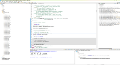

2025-07-07 1:23 AM - edited 2025-07-07 1:23 AM
2025-07-07 1:52 AM

2025-07-07 2:16 AM - edited 2025-07-07 2:16 AM
I updated STM32CubeIDE to version 1.18.1 (STM32CubeMX version 6.14.1), cleaned the project and rebuilded and still getting the same error.
Thank you for your feedback,
Arthur
