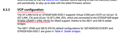

F429-DISCO is using USART1 connected to VCP:
From the user manual of the board:

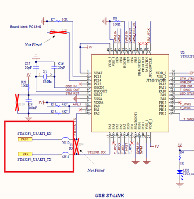

From F429-DISCO schematics:

@Emanuele78 wrote:I am using the STM32F429ZIT6 DISCOVERY KIT connected to the PC via USB ... I didn’t understand whether I should use USART3 or USART1
You need to use whichever USART is connected through to that USB connection!
That will be stated in the User Manual for the board, and can also be seen in the schematics of the board.
