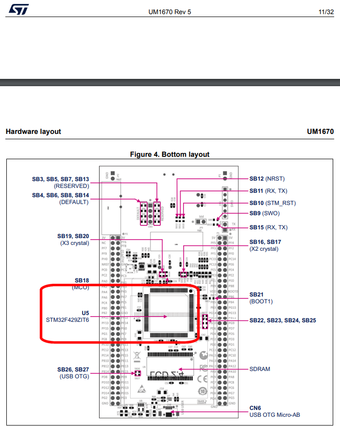

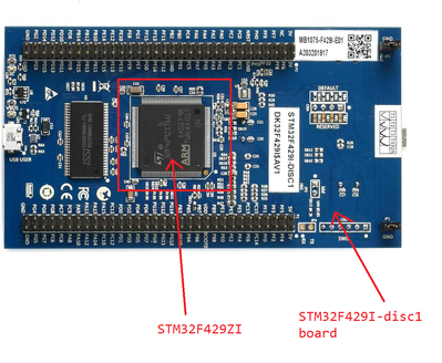

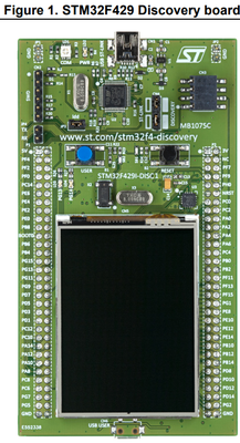

The difference between a chip and a board:
In this case, this is the STM32F429I-DISC1 board:
And this is the stm32f429zi chip (a microcontroller) - mounted on the rear of the board:

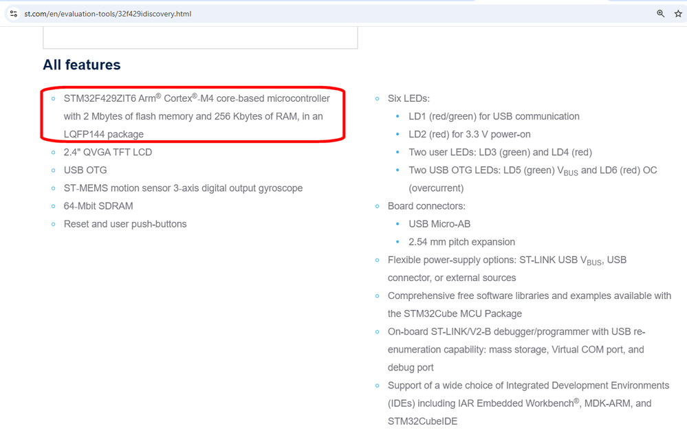

The board includes all these things:
https://www.st.com/en/evaluation-tools/32f429idiscovery.html
As you can see, the chip (the microcontroller) is just one thing (among many other things) on that board.
