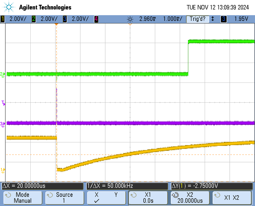

I just tested the shutdown wakeup with EXTI GPIO pulses with length of 35 us and it works correctly. Could you please let us know from where this 70ms in your request comes from?
purple is the tamper pin pulse to wake
2024-11-12 5:50 PM
Hi Bubbles,
The time of 70ms is the width of purple signal. It is 35us indeed in your picture.

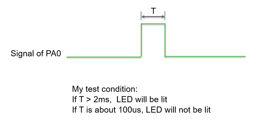

2024-11-17 10:18 PM
Hi @Bubbles ,
To reproduce my problem, I simulated it on the NUCLEO-U083RC development board.
I use PA0 as wakeup pin and If the MCU is awakened by PA0, the LED will be lit for 500ms.
This code has reproduced my problem.
The LED will be lit when the width of pulse is greater than 2ms.

2024-11-19 4:20 AM
Hi @xinmeng_wit,
the picture you put into your post is not precise. Did you try measuring the pulse using a digital oscilloscope?

2024-11-20 1:30 AM
Hi Bubbles,
The signal of PA0 is generated by another NUCLEO board. The signal should be ok.
I think the precision is not very important. What's important is that you can reproduce my problem. That is, given a large pulse width, the LED can be lit, and given a small pulse width, the LED cannot be lit. As for the specific width value, it can be reproduced and then measured in detail.
So now my focus is on whether you can reproduce this problem with my project code.
