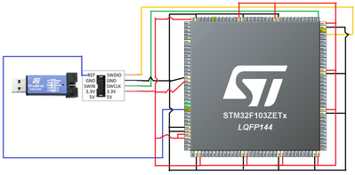

Im very stuck to reading pinout from datasheet, but I try configuration like this:
But still not connected. Btw, I just want to connect it for read flash test.
2025-06-20 6:37 AM
Is your STM32 on a development board? or a bare chip? If its on a board then tell us about the board like its name and make. Other wise if you are using bare chips, it still need few more connection in order to work. Like there are so many VCC pins but you have connected only one of them. Proper level on RESET and boot pins also required and decoupling capacitors also.

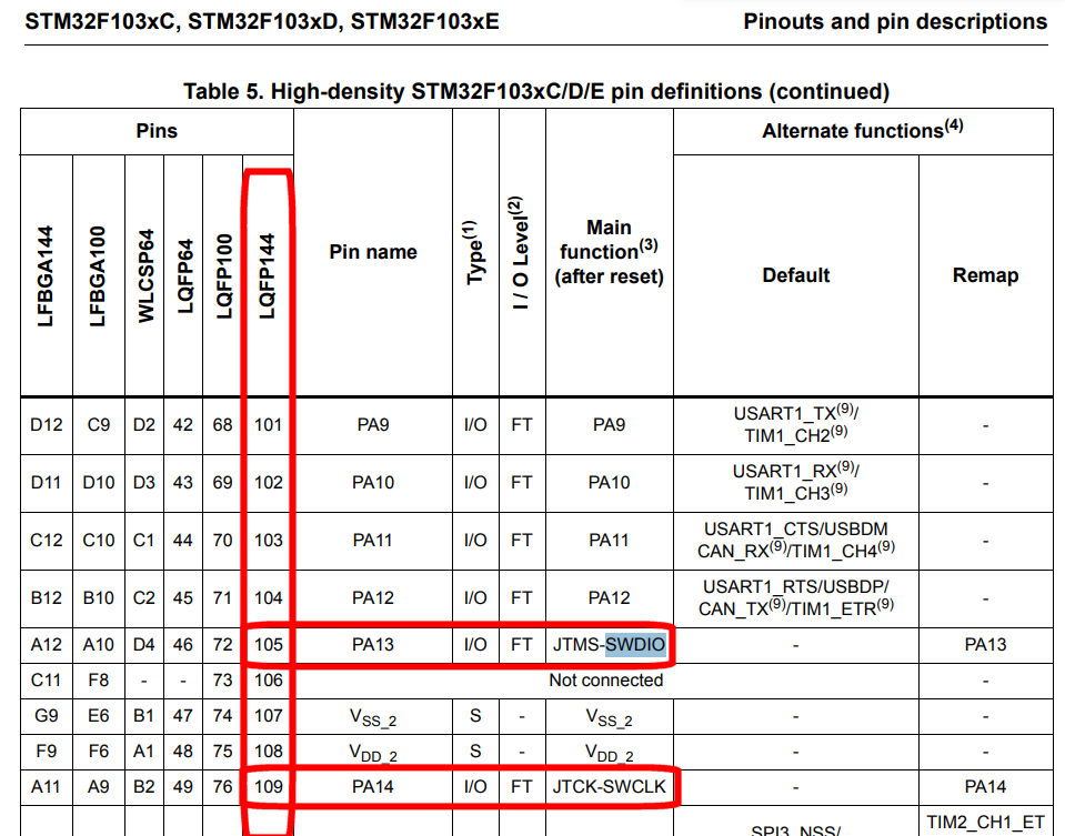

@tomero wrote:Im very stuck to reading pinout from datasheet
It's all in Table 5:
https://www.st.com/resource/en/datasheet/stm32f103ze.pdf#page=35
via: https://www.st.com/en/microcontrollers-microprocessors/stm32f103ze.html#documentation

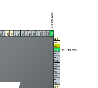

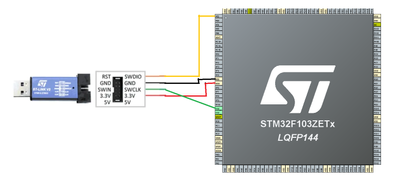

2025-06-20 12:24 PM
SWDIO = PA13
SWCLK = PA14
NRESET = NRST
GND = VSS (All), VSSA, VREF-
3V3 = VDD (All), VDDA, VREF+
2025-06-20 5:39 PM
Yeah, it looks like you're just randomly picking pins hoping for a connection.
The SWDIO and SWCLK are on the other side of the chip
