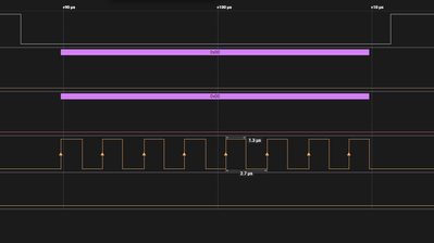

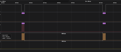

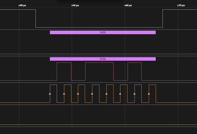

So far, we are seeing this happen on the SPI lines through a logic analyzer:
And we are not sure why...

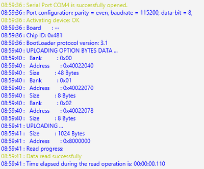

- Have You tried to used the VCP interface provided by the integrated STLINK on the NUCLEO board, to verify that the MCU is in Boot mode?

We were able to successfully connect the Nucleo board to the bootloader using the VCP interface and getting this output from the log:
