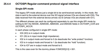

If Single-SPI of OCTOSPI works the same as the legacy SPI, do IO1, IO2 pins behave the same as MOSI and MISO pins?
2024-04-05 1:14 AM
Hi @giwonKIM ,
As mentioned in RM0468, if you want to use the OCTOSPI as SPI, the SO/IO0 signal will be used to output the data from STM32, then it is MOSI (master Output Salve Input). The IO1 (SI) signal will be used to receive data so it acts as MISO.

As long as you do not need a full-duplex SPI (MOSI and MISO in both direction at the same time - as a "regular" SPI is) - you can use OCTOSPI as "single SPI".
Bear in mind: STM calls it "single SPI" but not "regular SPI"!
It is NOT a full, regular SPI, not with full-duplex. OCTOSPI works only in "half-duplex" mode: Tx or Rx, but never both at the same time (not possible, see the commands you can configure, never READ + WRITE).
2025-06-21 4:01 PM - edited 2025-09-24 5:49 PM
I agree with your analysis. Lack of full duplex is not mentioned on the first page of the OCTOSPI chapter in the user manual, but reading through the rest of the chapter, I do not see a way to combine READ+WRITE. So despite having this relatively wide OCTOSPI block with 17 bullet points of features, there is no full duplex mode. If you need 2-4 data lines and full duplex, OCTOSPI can do one direction but you end up eating multiple SPI ports for the other direction.
