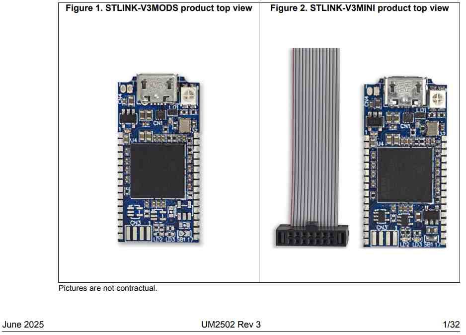

I’m using an STLINK-V3MINIE and I’m trying to fully understand the hardware on the probe PCB.
On the bottom side of the STLINK-V3MINIE PCB there is an unpopulated footprint labeled “CN5” (small pad footprint). I could not find any mention of CN5 in the user manual as a user-accessible connector, so I’m not sure whether it is factory/test/service only or an optional header.
I attached:
  • A photo showing the location of CN5 on the PCB (bottom side).

Hmmm... the ST-Link V3 MODS and MINI have a similar undocumented footprint (at bottom-left):
Maybe it's for programming the STM32 chip in production?
