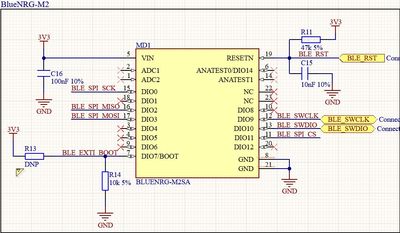

I recently designed and built a custom PCB for data acquisition and transmission through bluetooth using an STM32U575 as the main MCU and a BlueNRG-M2SA module for bluetooth data transmission configured as a Network Coprocessor. They are connected via SPI following the pinout on the BlueNRG-M2 datasheet and also looking at the X-NUCLEO-BNRG2A1 schematics. The BlueNRG-M2SA is connected to an external connector via SWD for flashing using an STLink-V3Minie. Resistor R13 is not usually soldered and is just used to enable the bootloader during image flashing. Schematic for the BlueNRG-M2 on the custom PCB provided below:
The problem is that I have not been able to achieve communication between the STM32U575 and the BlueNRG-2 module as whenever the main MCU waits for the IRQ signal from the BlueNRG-M2, it doesn't receive any and therefore returns BLE_STATUS_TIMEOUT and gets stuck after aci_hal_set_tx_power_level() during Device_init(). I have tried uploading different DTM images to the BlueNRG module, the ones on the BlueNRG-M2 website, both 2.1c & 2.1e and the ones provided with the BlueNRG-1_2 DK 3.2.3: DTM_SPI_M2SA.hex and also the NO_UPDATER version. On the MCU side, I am using the X-Cube-BLE2 middleware pack with HCI_TL set to Basic and HCI_TL_INTERFACE set to UserBoard and I have tried both the Beacon and SensorDemoBLE applications.

Please show the full schematic - including the STM32.

I attach the full schematic including the STM32 and the BlueNRG-M2. The project has two other schematic pages but are not related to the problem and are not connected to the BlueNRG-M2, they are additional sensors and external connectors.
I did not test with the X-NUCLEO-BNRG2A1 due to time and resource limitations but anyway, as I connected the BlueNRG-M2 module as in the X-NUCLEO-BNRG2A1 board and the only connection with the STM32 was via the standard SPI protocol and an External Interrupt, I didn't expect there to be any problem regarding the physical connections. However, I fully understand that this would have been a wise step to try before building the custom PCB.
