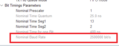

2026-04-28 8:18 AM - edited 2026-04-28 8:20 AM
Another issue I've just detected in your configuration:
Nominal bitrate is at 2.5Mb/s!! You must not exceed 1Mb/s in the nominal phase with FDCAN.
