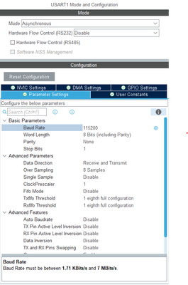

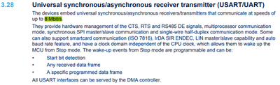

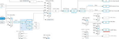

I would like to determine the maximum baud rate for a USART peripheral in asynchronous mode. In the datasheet (Figure 1) the maximum baud rate is given as 8 MBit/s. But even if I set the clock for the USART peripheral (in this case USART1) to the maximum of 56 MHz (Figure 2), I'm not able to set 8 MBit/s for the baud rate. I'm able to set 7 MBit/s when I set the over-sampling to 8 samples (image3).

Hello @max_hai
As per my understanding, as STM32U0 max operating frequency is 56Mhz, the maximum baudrate achievable on an USART peripheral in asynchronous mode, is 56/8, so 7Mbit/s when selecting Oversampling 8 method (3.5 in Oversampling 16). So my feeling is that the information in Datasheet is not exact.

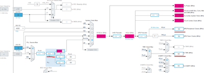

2024-12-12 5:37 AM
Could you please verify this information?
Because I just noticed that I can increase the USART1 clock without getting an error for that clock. But in this case I get an error for other clock domains that can only handle 56MHz, as you can see in the screenshot below. So I'm probably doing something wrong here, and a higher USART clock can be achieved with an external oscillator? But even this I cannot configure.

2024-12-12 9:55 AM
@max_hai
I fowarded this remark about 8Mbits/s reference into U0 datasheets to ST U0 team. It would be corrected in next release of datasheets. The official max baudrate is 7Mbits, due to the max 56 Mhz provided to USART peripheral.
@Andrew Neil
7Mbits is also the maximum achievable in Synchronous mode.
